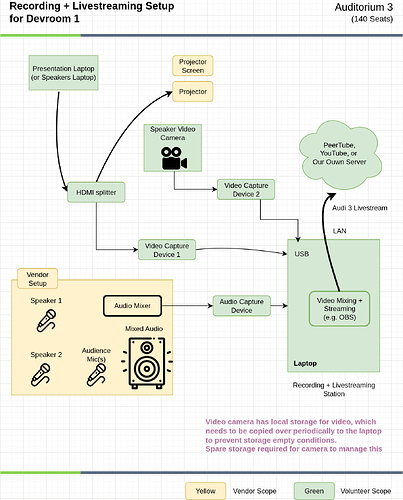

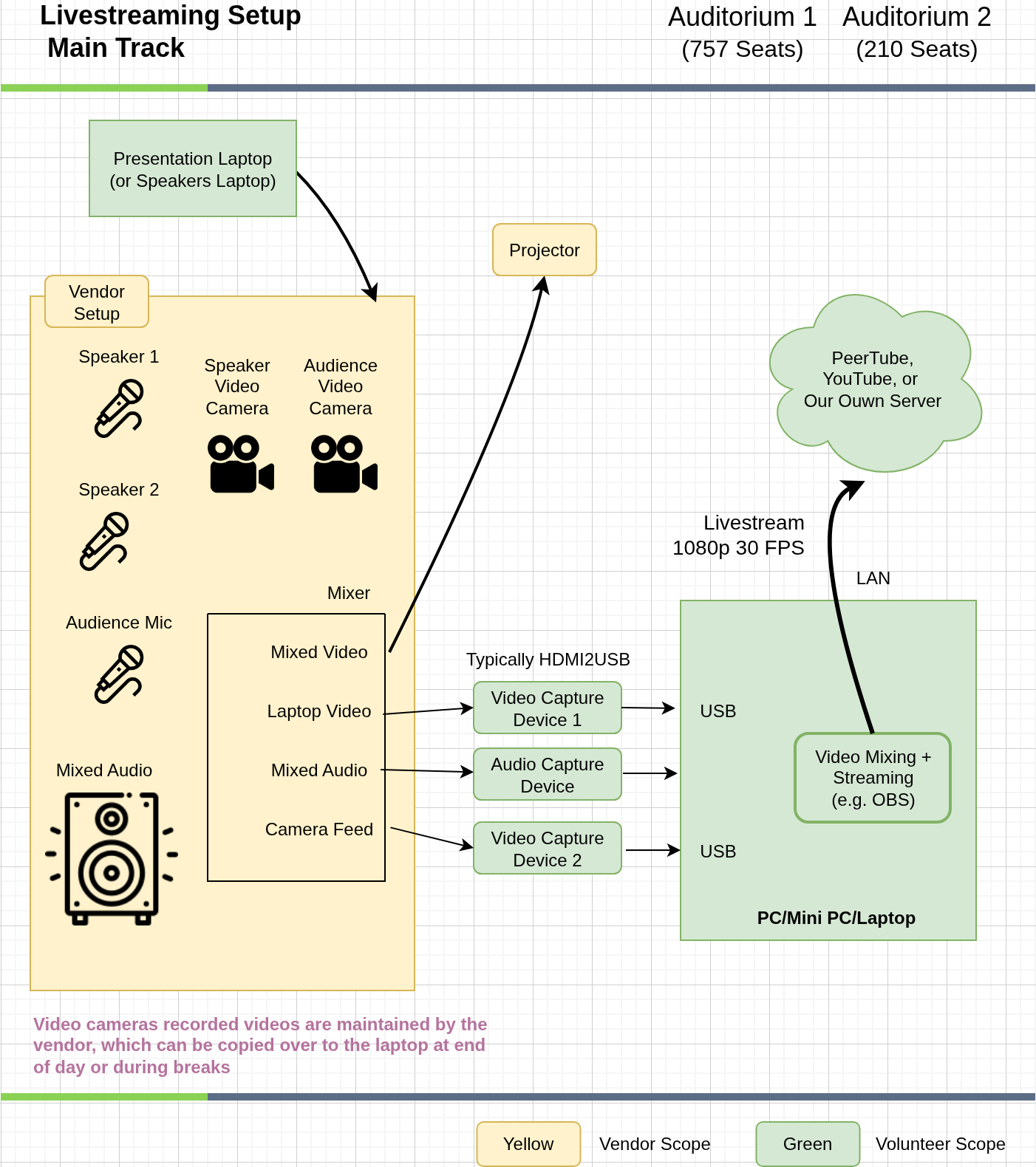

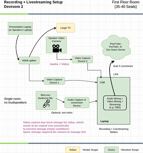

I made some diagrams to clarify that the scope and partitioning of the work is clearer. The diagrams show vendor and our scope in different colors.
In IF2024, we livestreamed Audi 1 and Audi 2 (main track). In IF2025, we will do that. Plus, we will both record and livestream devrooms - 6 sessions which will happen in two different places: Audi 3 (4 devrooms, each 3 hrs), and a room in the first floor(2 devrooms, each 3 hrs). The setups differ slightly.
Main track in Audi 1 and Audi 2 will use 2 cameras - one for speaker, one for audience during QA. These also have audio mixing done by the vendor, they manage the stream going to the projector as well. From our POV, Audi 1 and Audi 2 are similar setups.

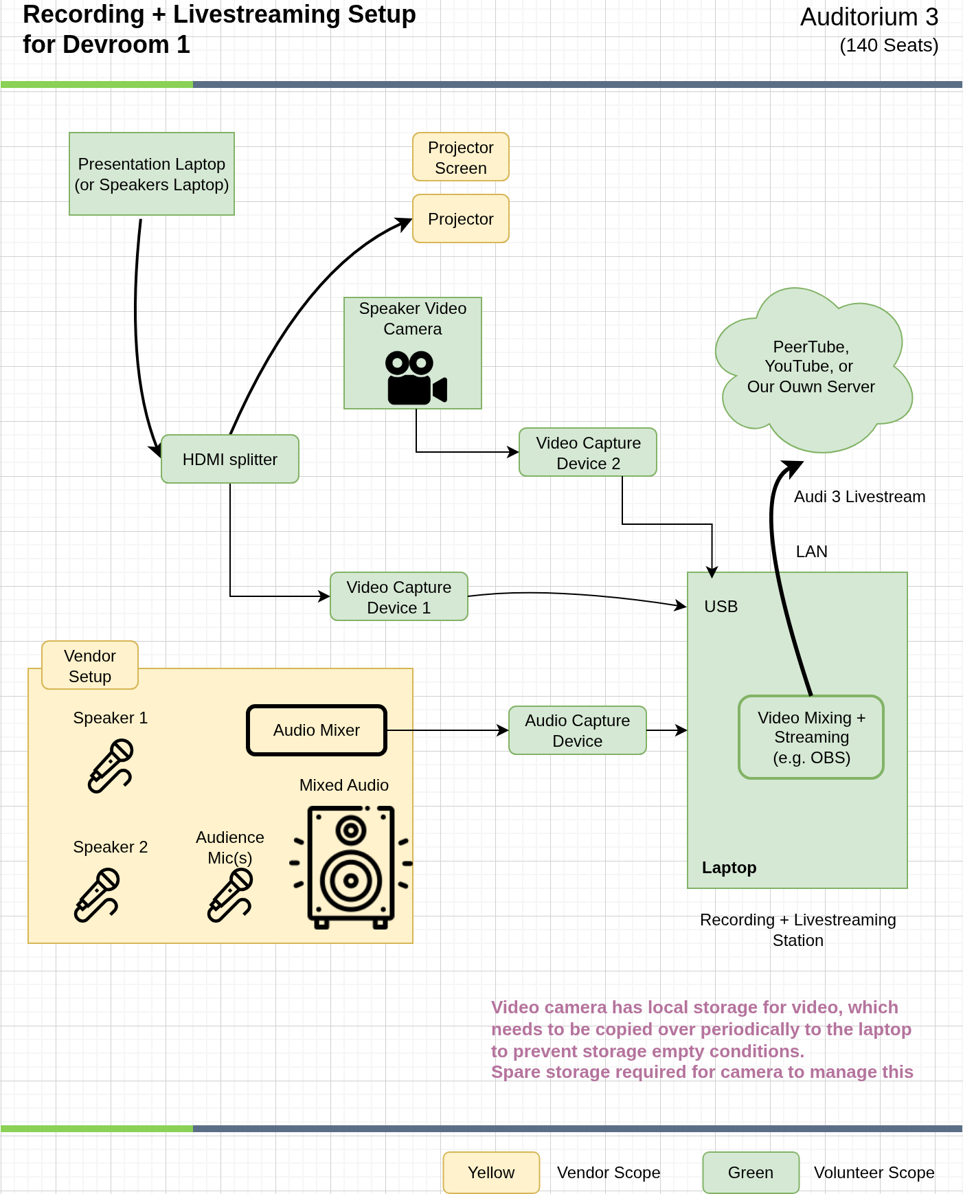

Devrooms will only have 1 camera, but there are differences in those setups. Devroom 1 (Audi 3) is larger, and thus needs dedicated audio. Vendor will do the audio mixing, and handle the loudspeaker as well. Video recording will be handled by a volunteer, who has to make sure that the camera follows the speaker.

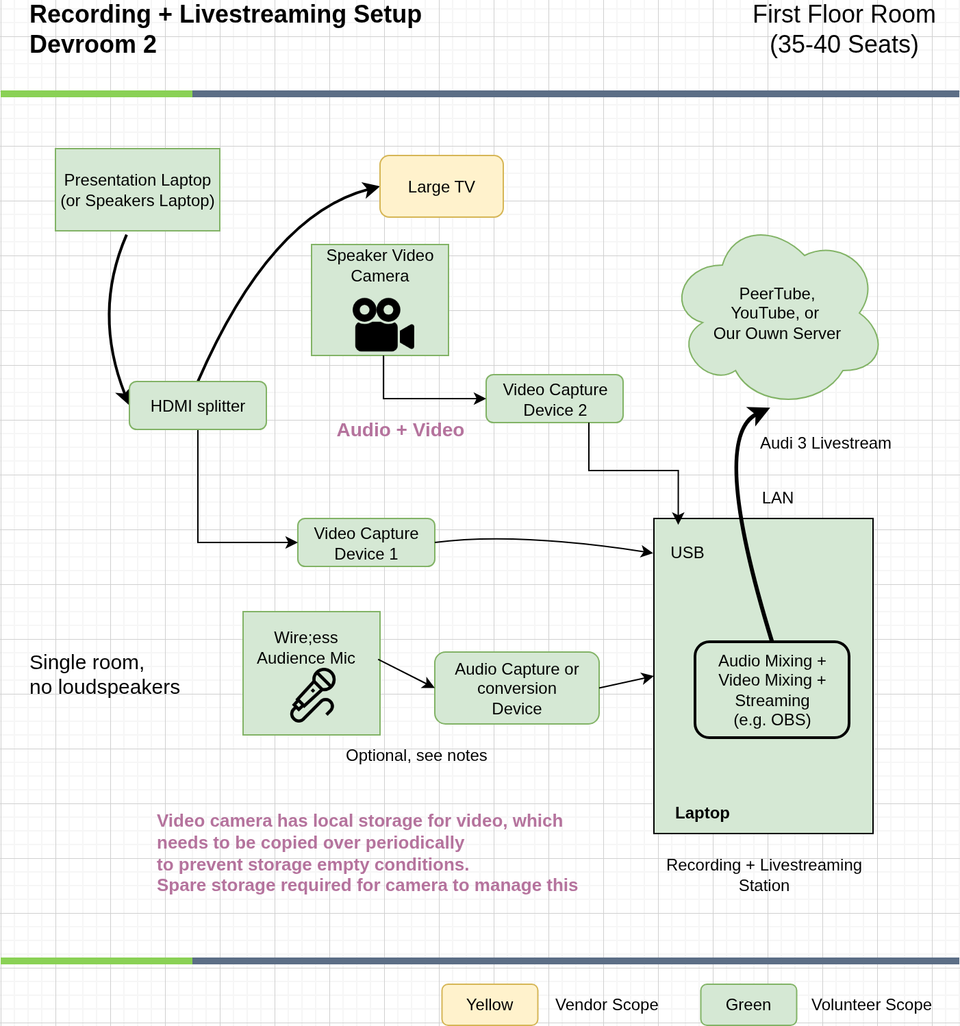

Devroom 2 being a small room doesn’t need a loudspeaker, resulting in a much simplified audio workflow (may or may not be simpler for us though).

I will describe the setups a bit more in detail here, with the simplest first.
Devroom 2 is in a small square room (35ish capacity). Speaker’s laptop is visible on a large screen TV. To capture this screen, we need to replicate the signal. That’s what the HDMI splitter does - it’s a commodity part. We’ll be dealing with 1080p resolution, so the absolute quality of this device will not matter so much.
The replicated signal goes to the large screen TV, and to a video capture device. The capture device converts from HDMI to USB 3.0 on the laptop. Similarly the video camera is also made available at the laptop. (Note : 2 USB ports gone).
Audio - will come in via the video camera - this becomes part of the USB 3.0 audio-video stream. We have QA at the end of the talk. When audience asks questions it doesn’t typically register in the video camera’s audio stream. There are two possible solutions : one that the speaker repeats the question before answering it… so that the question gets recorded. Other is to have an audience mic. Which then needs to be wireless, and this audio needs to be mixed with the speakers audio for recording.
The two video and audio streams are mixed into a video on the laptop. The laptop also sends the livestream to the cloud.
The video camera has local storage for the videos as well. This storage is limited and must be managed, using multiple storage cards, plus periodic transfer to the laptop.
An option here is to use a modified version of the FOSDEM video box. The Radxa X4 SBC inside the box may be powerful enough to mix the 2 video streams and stream it up.
A rental video camera must be chosen based on
  1. Reasonable low light performance
  2. Good autofocus with least volunteer assistance
Accessories would be multiple storage cards, power supply (ideally DC powered rather than battery). We’ll need a tripod also.
We also need a human volunteer to manage the setup. The tasks of the human volunteer are:
  1. Ensure that the speaker is in the frame of the video camera… just in case the speaker moves a bit farther during the presentation
  2. Ensure that all elements are working. Loose contact, pulled cables, loss of audio etc needs to be monitored continuously
  3. Handle “scene changes”. In different sections of the talk, the livestream will show different elements. E.g. in the begining the title. During the presentation, the speaker will be rendered side by side against the talk slides in the livestream. During QA ideally only the speaker video, but audio mix between the mics. During the lunchbreak/transition something else, etc. This will be input by the volunteer manually. This scene selection must be easy to do and take effect immediately.
The choice of the video mixer running on the laptop. It should be simple to use, easy to change scenes intuitively. OBS is commonly used. FOSSDEM uses voctomix.
We also need to look at where the livestream video goes, how the users will access it, and how it will be referenced in the schedule. To be resilient to network disruptions will take some work. Good amount of testing will be required to ensure we have a rock solid system for the conf. If we can give the job of this volunteer to a student and ensure everything works with minimal supervision, then it’s a win.

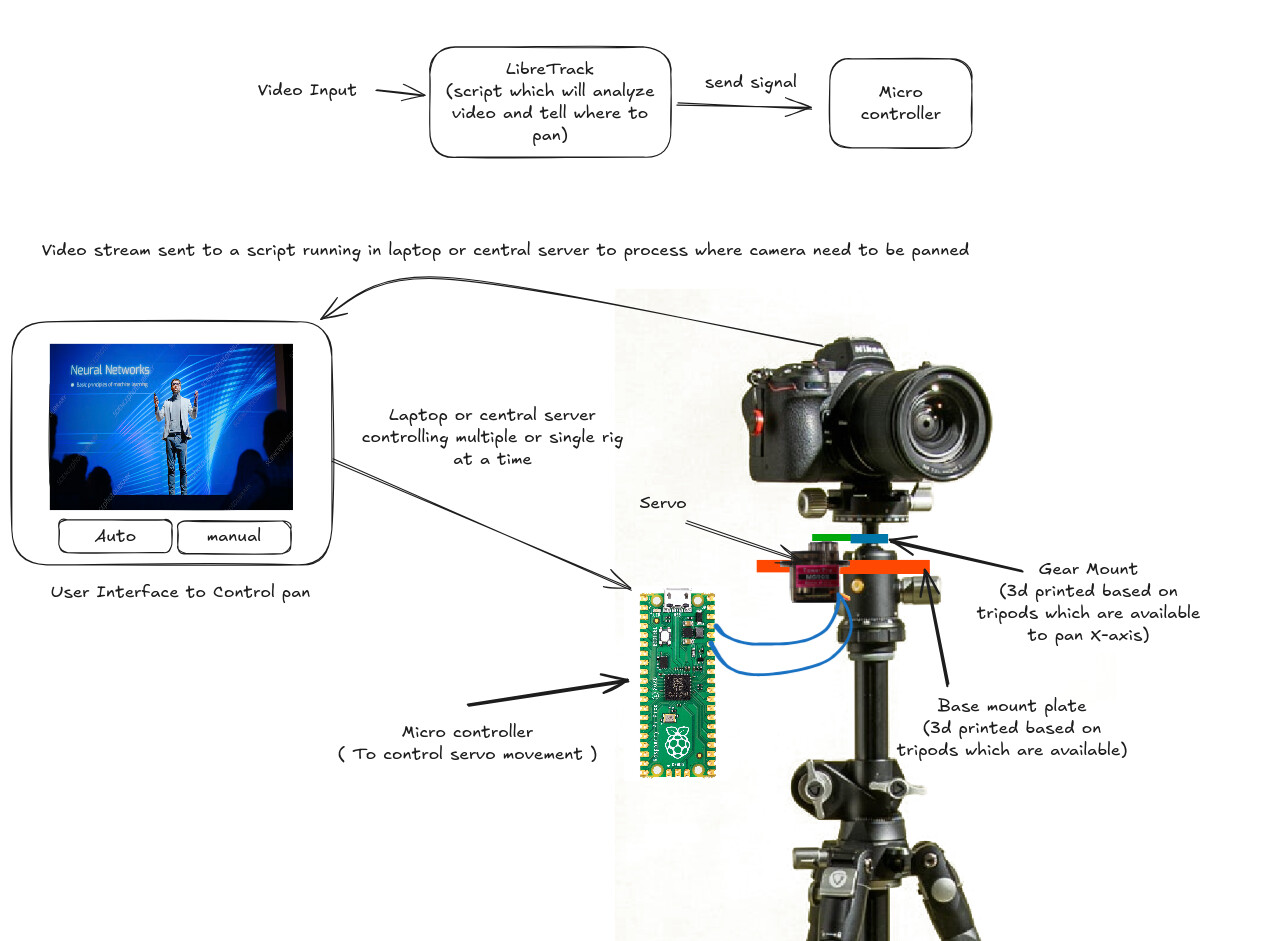

Hi everyone :wave:
I’m pretty new to the FOSS community , and I’d love to volunteer in building something that could be useful for live streaming events.
The basic idea:
  • Take the video feed from a camera
  • Use the current frame to detect where the speaker is
  • Automatically pan the camera so the speaker stays centered
  • Send the control signal to a microcontroller that moves a servo motor
I’m also thinking about:
  • Designing 3D-printed mounts for the tripods we already have
  • Building a simple user interface to let someone choose between auto-pan, manual pan, stop, etc.
Would be happy to work with others on this. any feedback, ideas, or collaborators would be awesome!

Welcome to the forum, @5zan ! Good to see you. In fact, this is very similar to what we were discussing in our meeting last Sunday. One of the guys who may have taken this up unfortunately had to back out. I think you are here at just the right time. Thank you in advance :grinning:
The good thing is that there are of course designs online for 3D printed mounts. Starting points, but I am not sure if we can use them as is (reasons follow). But of course now we have you also - so very happy to discuss.
I assume you’ve looked at the preceding posts. For the conference (20,21 September) we’re gonna have the HDMI output of the camera going into a HDMI video capture USB device. The video stream is thus available at a laptop. So, “libretrack” from your diagram would run on the laptop. The microcontroller could connected over USB as well.
Some aspects of the tripod are of course reasonably standard - e.g. the mounting screw. However, one aspect we will have to consider - the weight of the camera. For IndiaFOSS 2025, we are actually actively considering a Sony FX6. The weight of the camera may make this an interesting thing, as you would imagine.
While choice of the camera isn’t set in stone yet, the reason to look at that camera is that we really want to get a good video camera with excellent low light performance, and great auto-focus performance in terms of eye tracking. This camera is listed for rent for ~4200 Rs/day btw, which is a significant premium on DSLR cameras which typically are around 3000 Rs/day. But that cost difference is acceptable for us.
The camera will record video locally, as well as output over HDMI. The HDMI output will be used both for livestreaming and for tracking the subject. We want to livestream 1080p resolution.

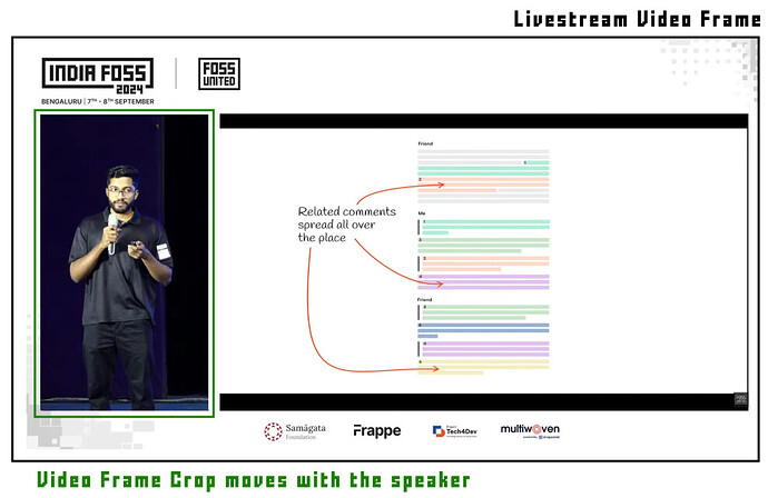

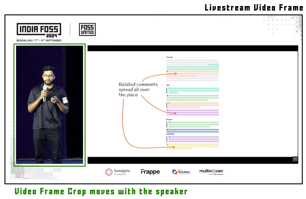

Technical possibility: It may also be possible to track the speaker without moving the camera all the time. Let’s say we 4K stream over HDMI, track the speaker, and follow the speaker by changing the “crop” window. This additional layer of “following” the speaker can potential make camera motions smooter/better managed as well. For small speaker movement, we change the crop window. For larger movements, we track with the camera and crop the window. The crop window can follow the aspect ratio of the speaker rectangle shown in the livestream, which will make this more interesting :grinning:
As a concrete example - see this part in last year’s livestream, screenshot here:
Thoughts ? Also - are based out of Bangalore. Asking as that may make some things easier…
